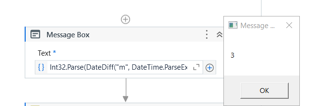

Int32.Parse(DateDiff("m", DateTime.ParseExact("09/30/2023", "MM/dd/yyyy", System.Globalization.CultureInfo.InvariantCulture), DateTime.ParseExact("12/31/2023", "MM/dd/yyyy", System.Globalization.CultureInfo.InvariantCulture)).ToString())
Assign variables -->“09/30/2023”,“12/31/2023”

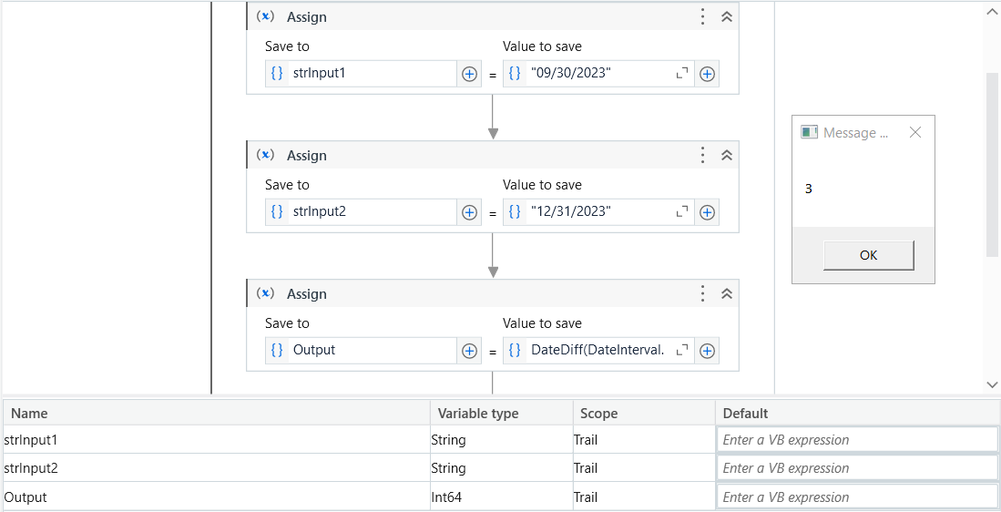

Hi @sruthesanju
You given one date which is 09/31/2023 in september month, there is only 30 days but you have given 31, change the date and follow the below,
Try this:
- Assign -> strInput1 = "09/30/2023"
- Assign -> strInput2 = "12/31/2023"
- Assign -> Output = DateDiff(DateInterval.Month, DateTime.ParseExact(Strinput1.ToString, "MM/dd/yyyy", System.Globalization.CultureInfo.InvariantCulture),DateTime.ParseExact(Strinput2.ToString, "MM/dd/yyyy", System.Globalization.CultureInfo.InvariantCulture))
Note : Output is the Int64 datatype variable.
Hope it helps!!

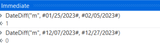

Depends on the precision which is needed
We ask for this detail as DateDiff is not handling the fractions:
EDITED: Fixing Typos, Added example of a fraction
