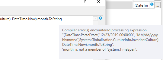

Dear @Palaniyappan,
Sorry For Slow Response, but i got this error.
Aah
Sorry buddy that was my bad
The expression be like this
(Convert.ToInt32(Datetime.ParseExact(“10/23/2019 00:00:00”,“MM/dd/yyyy hh:mm:ss”,system.Globalization.CultureInfo.InvariantCulture).ToString(“MM”))-datetime.Now.Month).ToString
Cheers @aliaga
Hi @Palaniyappan,
Im so Sorry for asking you again. could you send me some sample in assign sequence?
i got an error like this
