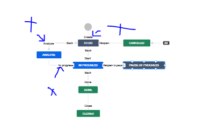

please see below image
here you can see there are so many transitions like create, To refine, start, Start Refinment and it differs project to project in jira.
my requirement is to click on each transition and do certain actions.

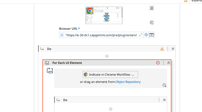

can you show a picture in debug mode as well and what is happening
cheers
u can cehck this ss
