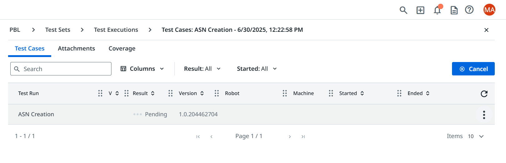

I am trying to run a test case from Orchestrator in un-attended mode, but every time it goes into Pending status and test case doesn’t get executed. I have an On-Perm Setup. Any help to resolve this will be much appreciated.

Assign testing runtime to your machine like below. As test cases requires testing runtime.
Thanks for replying. I have already done that
@madhukar.anand are you able to run the unattended jobs with same machine and robot account?
Yes I was able to. The issue has started from today
@madhukar.anand can you check if any of previous executions are stuck and still in running status?
Go to Orchestrator → Tenant → License → Testing → See More → observe if the Machine is Active and its License Status
