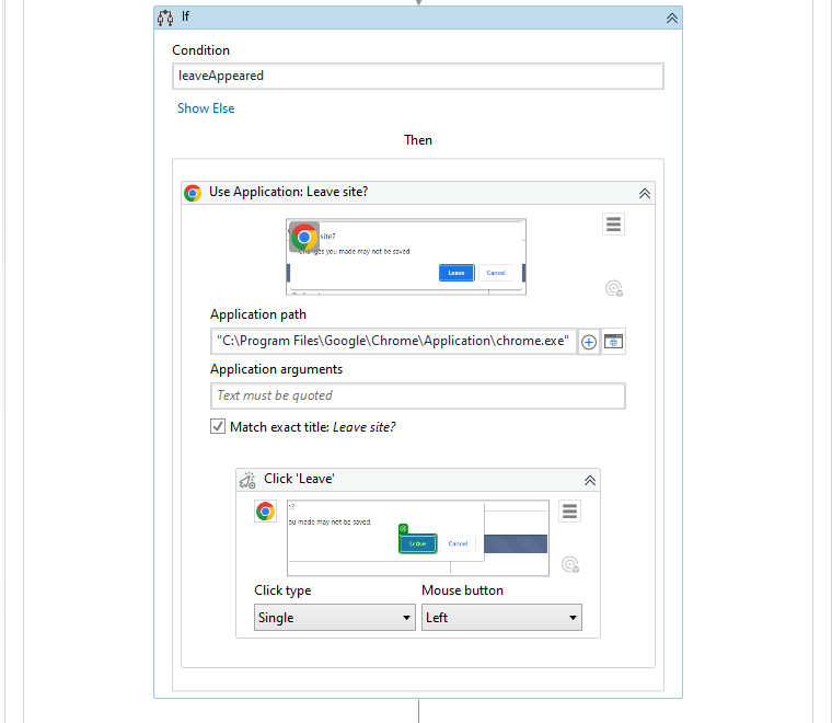

I don’t know why, but for this automation I’m doing in nCino (Salesforce) the first transaction works fine, but then the second one fails on some selectors. I’m sharing this in case anyone else runs into the same issue. I don’t know what exactly is happening, but I figured out that refreshing the page fixed it. Something odd about how the lightning interface works, I guess.
So what I do is after each transaction I click Home, and then refresh the page:
Thanks mate, I spent 2 sleepless nights with selectors wondering what was wrong.
