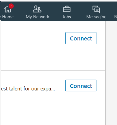

Hi, any idea how to automate the connection requests sent to the contacts?

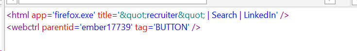

The below value after ember keeps randomizing , which it makes it even harder. Any other workarounds?
Don’t use the ember id’s they are randomised every time the page loads. Best to use the CSS selectors. Open in UI Explorer and update your selectors their, then validate them before saving them.
@whity
Use wildcards * in parentid or any other dynamic attribute values buddy…that could take any value changing from time to time
To find the dynamic attribute do it manually two-time on the same page so that you will get two selectors…you can compare that and get to know the difference…
