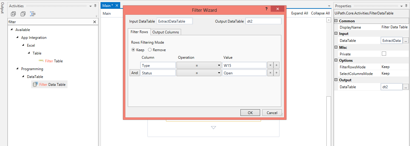

Yes, struck at getting the only the items needed in the current process - those of the WI5 type, with the status set to “Open” in the table of WorkItems ,
Am getting all the items from the table which I did in below xaml,
Main.xaml (13.5 KB)
Thanks in advance.
After you get all the items,
use filter data table activity to filter the WIIDs
condition1 - Type Equals WI5 AND
condition2 - Status Equals Open
https://activities.uipath.com/docs/filter-data-table
With out filter data table activity -
Please use double quotes for everything -
Type → “Type”
Status → “Status”
WI5 → “WI5”
Open → “Open”

Am getting WI5 items only two from the table, where I scrapped and put into the excel sheet, below is the screenshot,
Main.xaml (20.5 KB)
Can I know what is the mistake there!! @KarthikByggari
Hey @sushmithaelluru
There is no problem with your workflow Either with IE or Chrome
Just try reset your test data of your account then try
Regards…!!
Aksh
Ok @KarthikByggari, will check.
Ya ok will reset:slightly_smiling_face: @aksh1yadav
Got the WI5 related items… @KarthikByggari , @aksh1yadav…
