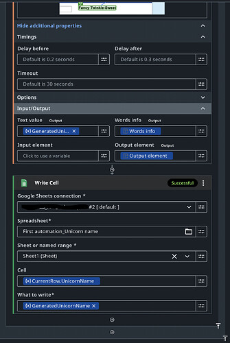

Here’s the issue:
When I run the automation, it updates only the A1 cell in the spreadsheet with the last Unicorn name, even though the Write Cell activity is included inside the For Each Row block. It seems as if the Write Cell is outside of the loop.
From what I can see, everything in my workflow looks correct, so I’m wondering if this could be an issue related to Google Cloud integration or something I’m missing in the loop logic.

With screens (process and final Spreadsheet)
Check the CurrentRow.UnicornName cell like what it returns. I think it is returning the static cell value in which your process is continuously overwritting the data.
  1. Read the spreadsheet → Read Range → store in DataTable(e.g., dtUnicorns).
  2. For Each Row in dtUnicorns:
  • Generate the Unicorn name.
  • Update the DataTable column:
row(“UnicornName”) = generatedName
  1. After the loop, use Write Range to update the spreadsheet (do Not use Write Cell inside the loop).
@Simon_DA_ROS

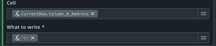

you need tp pass the address not the column alone
cheers

Hi @Anil_G, thank you !! It’s working, it has to be the address :slight_smile:

@Indhu_C_N
Even that has a similar attribute…just use currentrow. and it would pop it
