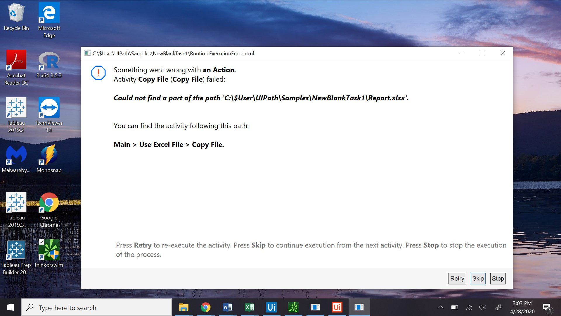

Hi… I have been trying the currency converter example and able to follow through most of the steps. I am having a challenge with saving file in the reports folder and giving me this error. Thanks for your help in advance.

Hello! I’m getting a similar error message when trying to follow along with the sample activity in the “Working with files and folders” lesson. See the screenshot below, as well as the full error message.
20.4.0-beta.718
Source: Move File
Message: Could not find a part of the path.
Exception Type: System.IO.DirectoryNotFoundException
RemoteException wrapping System.IO.DirectoryNotFoundException: Could not find a part of the path.
at System.IO.__Error.WinIOError(Int32 errorCode, String maybeFullPath)
at System.IO.__Error.WinIOError()
at System.IO.File.InternalMove(String sourceFileName, String destFileName, Boolean checkHost)
at UiPath.Core.Activities.MoveFile.Execute(CodeActivityContext context)
at System.Activities.CodeActivity.InternalExecute(ActivityInstance instance, ActivityExecutor executor, BookmarkManager bookmarkManager)
at System.Activities.ActivityInstance.Execute(ActivityExecutor executor, BookmarkManager bookmarkManager)
at System.Activities.Runtime.ActivityExecutor.ExecuteActivityWorkItem.ExecuteBody(ActivityExecutor executor, BookmarkManager bookmarkManager, Location resultLocation)
Okay, so I think I figured it out. If I create the folder for the invoices to copy into, it works! However, I thought that StudioX could create folders? Or can it only create files?

I think I have been able to figure out the issue. Since the bot cannot create a folder (without a Create Folder activity), the Reports folder has to exist for the bot to be able to save a copy of the Excel (Report.xlsx) file there.
  1. Within the project folder where you have the Report.xlsx file, create a folder named Reports
  2. Then try running the automation again.

I have the same problem from the Currency Conversion demo on RPA Starter course. I also added a Reports folder like @afe.araromi said with no luck. I’m thinking it’s a permissions problem. Currency Converter 7_4_2020 6_20_12 PM|690x366

Can you please show the properties of the copy file activity.
Mukesh
Here you are @mukeshkala
Please make sure - The folder path mentioned here should exist. Both the folders should be available
