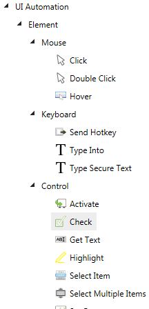

You can use Check activity under Control. It will check the radio button, if it is not checked and will do nothing, if already checked.
thanks
