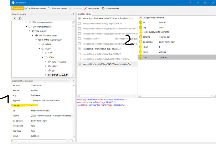

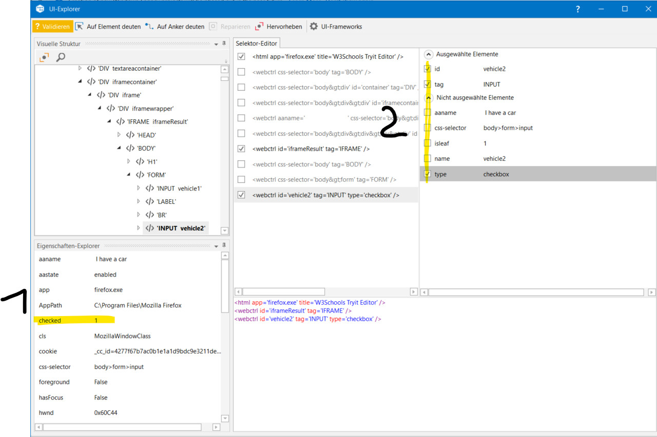

let us clear seperate between:
1: available attributes
and
2: offered selector attributes
when telling:
it sounds like referring to 2: offered selector attributes
with the feedback:
we are referring to 1: available attributes and did also not use within the selector
for analysis we use:
  • UiExplorer and/or
  • Browser F12 Web tools, which we already can open by F12 e.g. when right click inspect element is blocked
@Surendra_Bonu
as a first step try to open ui explorer indicate the element when check and uncheck and see what proeprty values are changing
that si the property that you need to check
as it is iframes and divs there might not be checked proeprties but the class might different etc which can trigger scripts
cheers
