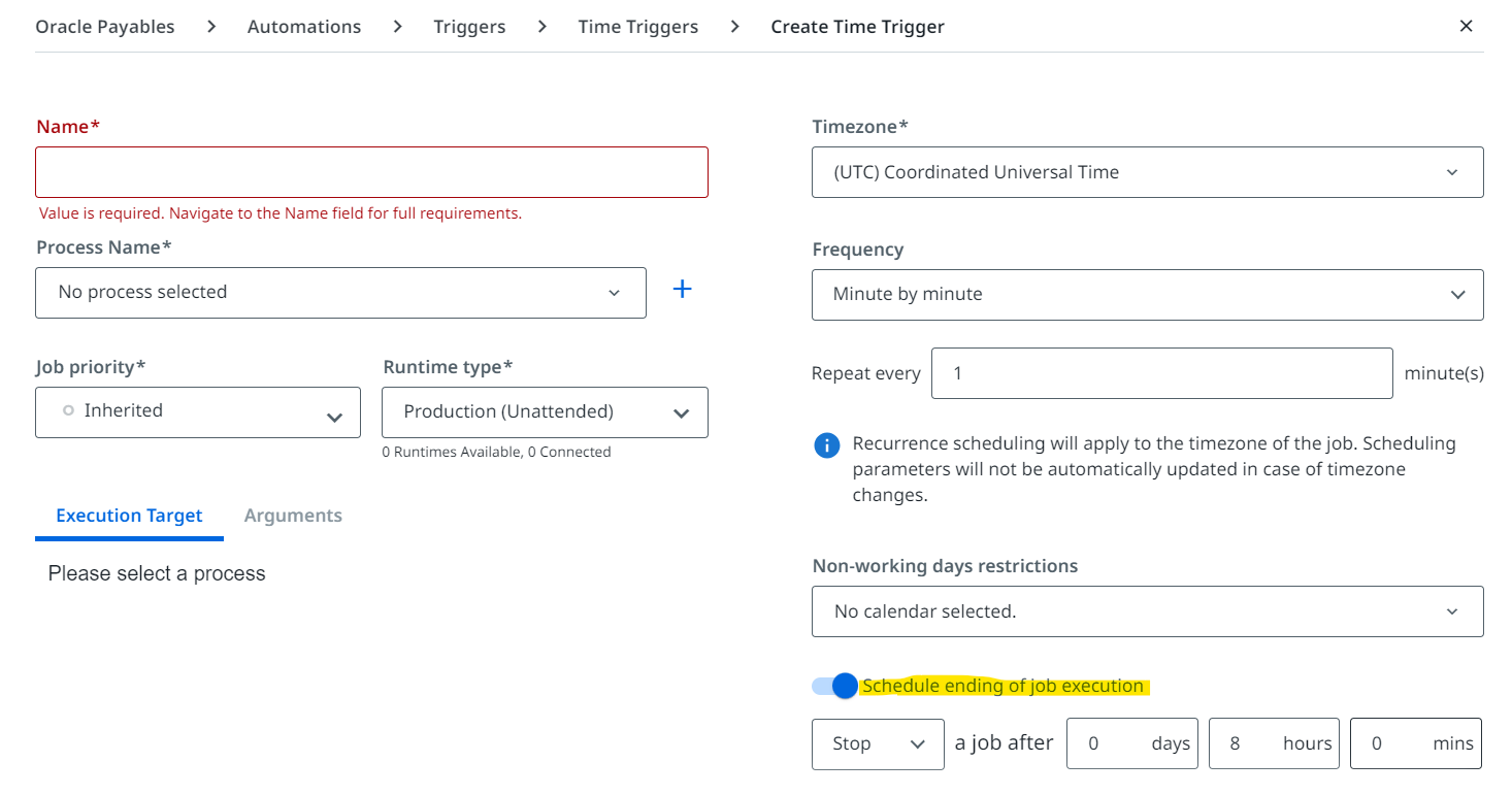

  1. if suppose there are 50000 records in queqe and the robot has to start from 6 am and it need to exactly stop at 2 pm … how to stop it exactly at 2 pm ?
Hi @Pooja_Kanwar

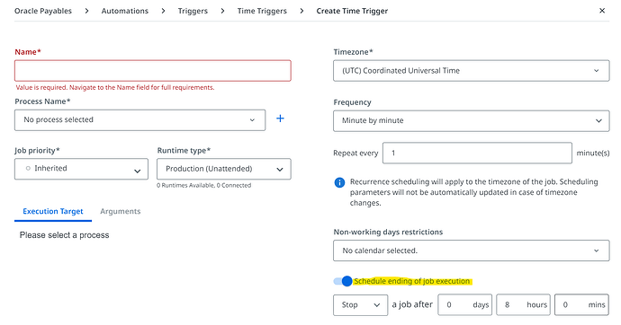

You can schedule the bot to start at 6 am using the Time Trigger. When setting up the Time Trigger, enable the “Schedule ending of job execution” option and enter 8 in the hours field to stop the bot at 2 pm.
If you want to terminate the bot exactly at 2 pm, select the “Kill” option from the dropdown. This will abort the process immediately, even if the bot is in the middle of executing a queue item. If you select the “Stop” option, the bot will complete the current queue item before stopping the execution.
Hope it helps!!
Other solution - but not ending exactly 2 pm.
Every time the proces try to get a new record - you can check if the time is before 2 pm. Make an if with condition like ‘now.tostring(“hhMM”)<1400’
If you know a record takes 4 minuttes - just change the condition to 1355.
