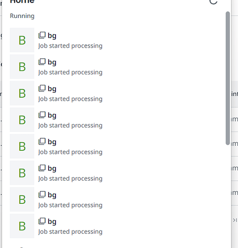

At least, 6 background processes run at same time in my environment (23.10.0 Enterprise).
To again iterate on the docs shared, we see that for attended, we will not have any issues with running multiple background processes with a Single Attended license, however for Multiple Processes to run in an unattended manner, we do need the equal number of runtimes/licenses for it.
As mentioned in doc…we can start multiple using attended…I dont see any limitation. A Simple test would reveal the same, Started almost 10 instances in a go
