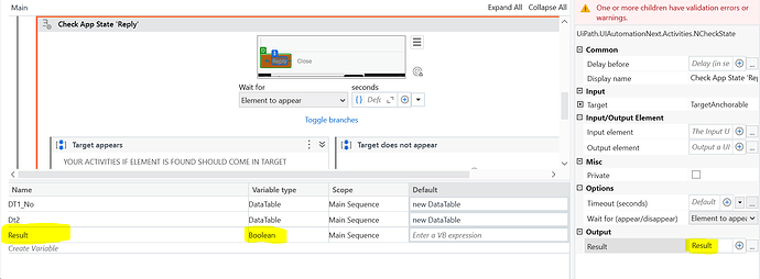

check app state is only using ienumerator object type only not supporting boolean :frowning:
Hi, not sure If i am getting your problem,
but check app state can generate result in boolean value, which you can use in dowhile or also in Retry scope

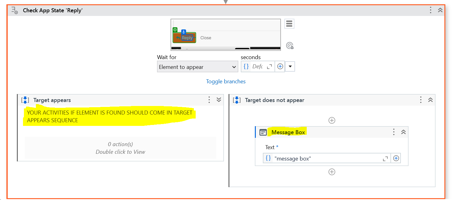

Hi @Sathish_Ashokan
As you said you can use the check app state activity to check the Ui element is exist in the foreground or not.
The Check app state activity has two block, one is Element appear and Element does not appear.
Element appear block will execute when the Ui element exist in the foreground don’t give any activity for continue the next iteration.
In the Element does not appear activity insert the message box to show the message.
Check the below image for better understanding.
Hope it helps!!

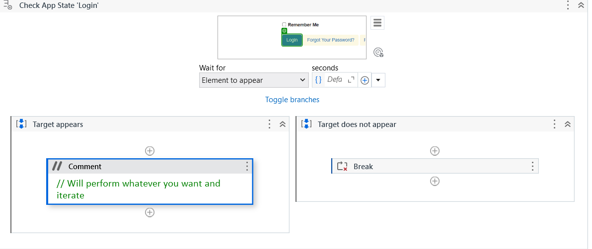

Hi @Sathish_Ashokan ,
Do u want to exit out of your for loop?If so then:
  1. If element not found Check app state will go to the respective not found branch
    Add a break activity,the control will come out of the for loop
