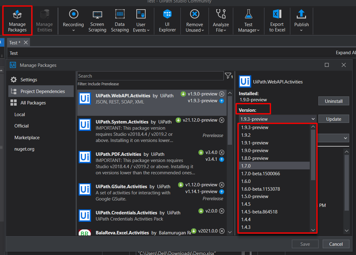

Hi @Seema_Jethe
Go to Manage Package → Select your Packing _> Degrade the version
For sample reference

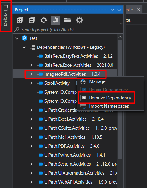

@Seema_Jethe
You can try with Remove the dependency from the project folder
Try to drag the activity again and give the input and ouputs as you mentioned before
Hope this may help you
