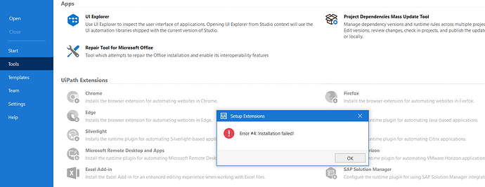

I cant install the chrome extension. I get error messages while trying the install
I cant install the chrome extension. I get error messages while trying the install it. Can somebody please help out?
Try uninstalling and reinstalling the extension. If that doesn’t resolve the issue, could you share the error message you’re seeing
Thanks. Let me try it now.
What error you are getting?
I think the issue is that it hasn’t even been installed in the first place. soo I cant uninstall and reinstall. Please see the screenshot below!

@V_O,
Ok, your antivirus could be blocking the installation. Try disabling the antivirus software on your machine.
I have but it still not working. I am on my PC.

You can install extension using CMD follow the below step:
Go to below path and launch CMD
/c “C:\Program Files (x86)\UiPath\Studio\UiPath\SetupExtensions.exe” /chrome
And hit enter
Check you local path where setupextension.exe exist go to that folder and run this common in CMD
SetupExtensions.exe /chrome
Hope this if so please maske as solution :white_check_mark:
This is a genius solution.
It worked with a little tweak. I removed “/c” at the beginning and added “&” (see below) before it was successfully executed and the extension installed. Please not that you have to close all Chrome activities for proper installation. After that, go back to the UiPath studio and install the chrome extension again or not. But its a must if the error sign appears on the oinned chrome extenision.
& “C:\Program Files\UiPath\Studio\UiPath\SetupExtensions.exe” /Chrome
