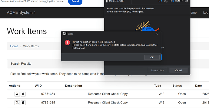

I just can’t get Table Extract Wizard to work. I’m following along an Academy tut, and I go to ACME website, and to Work Items. But when I try to select the table, I get this:
What am I doing wrong? Is there someway to select it without using the wizard?

No matter what I do, the same errror occurs. Is it because I’m passing in the URL as a variable so somehow the wizard isn’t reading the right target url?
@Terry_Marr,
That’s the issue. Try passing default value to your url Variable. It will allow you to develop this and once done, you can remove default values.

Hi @Terry_Marr
Pass the url in the field of use browser/application activity and then it will allow you to indicate the elemets. Once the indication is done, remove the url and pass the variables and make everything dynamic as per your requirement.
