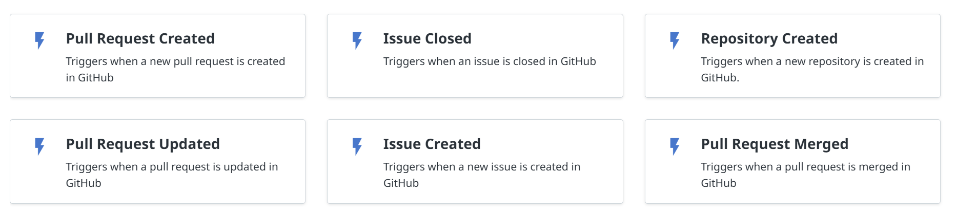

@surathak,
I don’t think can monitor the commit event but we have these events in UiPath Integration Services - Github connector
