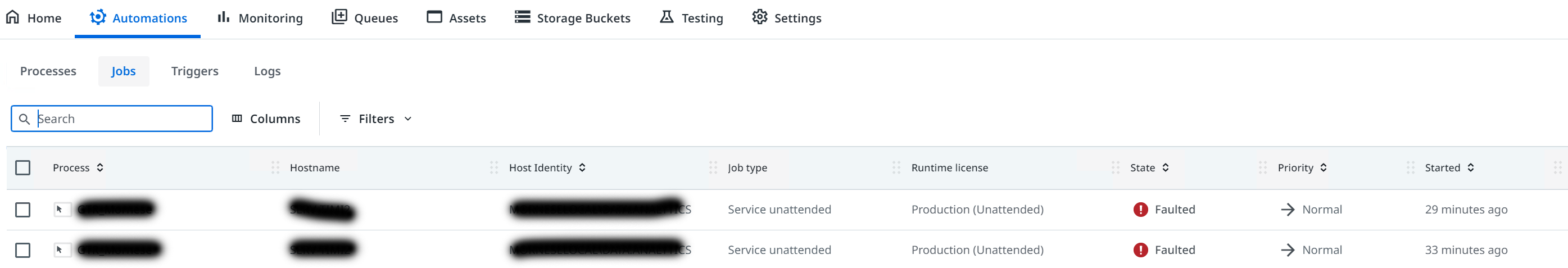

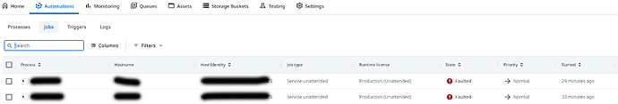

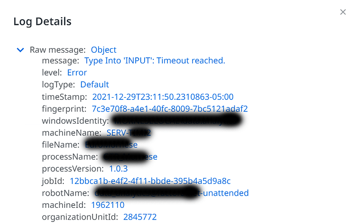

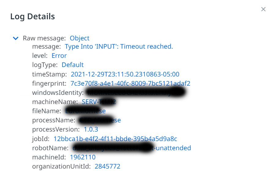

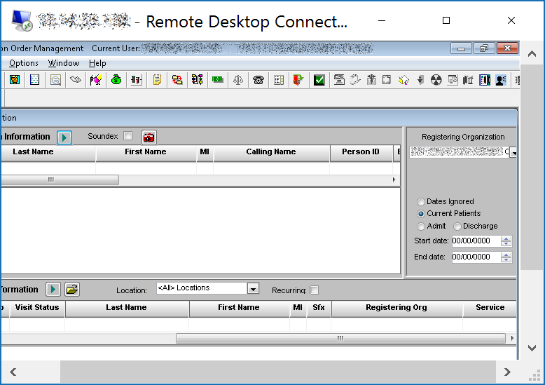

Here I attach some screenshots of the error messages. When I run it being in the remote desktop, everything works ok, but when I do it without using the remote desktop that error occurs, of the whole process flow it only opens the url but cannot find the input.

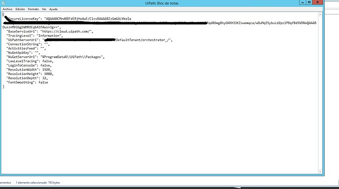

Yes, I did the uipath process at a resolution of 1680x1050, I configured that resolution also in the uipath.settings file and also in the orchestrator, but the robot still does not work. Can someone help me remotely to view my settings?
I did a test guiding me from here:
When I am connected to the server using the remote desktop, it works perfect and takes a screenshot, but when I close the remote desktop with the user session active and scheduling a trigger, it doesn’t work and the log records the following error:
Are you sure it’s a resolution issue? I bet you’re using Hardware inputs for your Type Intos. Try Simulate Type.

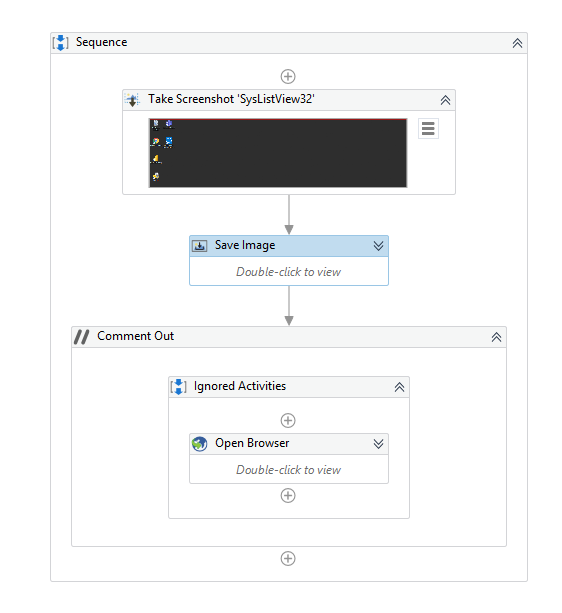

In the last capture I commented on the entire logging flow, I only left two activities, the one to capture the screen and the one to save the image. When I am connected to the server by remote session the normal orchestrator trigger is executed. But when I set it to run in 10 min and then I exit the remote desktop session and then re-enter the session after 20 min but I verify that the execution has failed.

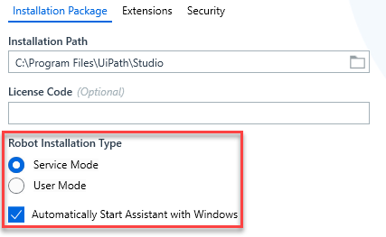

It appears the download provided through Automation Cloud Portal is now a MSI for Community UiPathStudioCommunity.msi

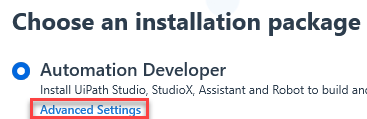

If running this installer by UI you are presented with Quick or Custom installation, if doing the Quick installation it will install in User Mode by Default, so you’ll want to opt for Custom install.
Depending on if you plan on using Studio in this environment you’ll want to then choose Automation Developer or Unattended Robot. If you select Automation Developer you then also want to select the Advanced Settings as the default will install in User Mode.
After selecting the Advanced Settings, be sure to switch the Robot Installation Type to Service Mode. It’s up to you whether you want to “Automatically Start Assistant with Windows” or not, this is more of the Client / UI of the Robot Service and is not required for unattended Jobs, but gives you as a user a visual indicate to the status of the Robot Service and Connection to Orchestrator from the Client Host.

If you have not done so already, I would uninstall / reinstall UiPath on the remote VM Selecting the following options
  1. Automation Developer
  2. Advanced Settings
  3. Service Mode (and select “Automatically Start Assistant with Windows”, if desired)
Once you have the Robot registered as a Windows service, you should be on the right path to running an unattended job on your remote VM.

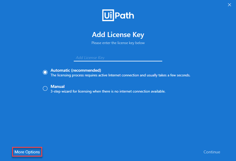

If you are using the UiPathStudioCommunity.msi installer available from the Cloud Portal, then it should not be asking for a license directly during installation. When you launch Studio (At the end of the installation) it should ask you to connect to Orchestrator. If you did not install Studio and only the Robot you can manually launch Assistant and open the Orchestrator Settings.
If you opted to include Studio and if it asks you to Add License Key, select the More Options on the lower left corner which should present you with 3 options.
Select Connect to Orchestrator and provide your Orchestrator URL and Machine Key
