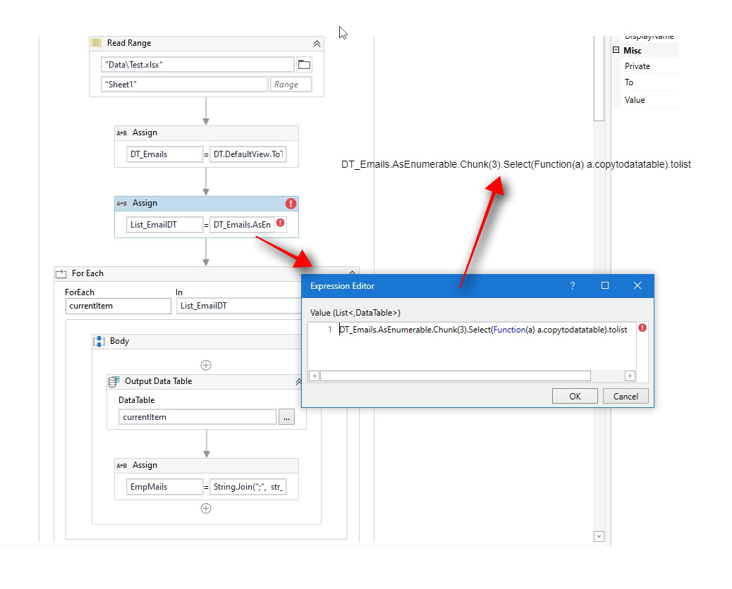

  1. I see the following error in the values of list of data table expression (DT_Emails.AsEnumerable.Chunk(3).Select(Function(a) a.copytodatatable).tolist)
    Here is the error: ‘Chunk’ is not a member of ‘System.Data.Enumerable Row collection (of System.data.DataRow)’

Available when Project is set to Windows Compatibility
When Project is set to Legacy Compatibility we can work with skip/take

How do you re-write the above expression (DT_Emails.AsEnumerable.Chunk(3).Select(Function(a) a.copytodatatable).tolist) using Skip/Take. I am a little bit confused.
Thank you!
@ppr
Just an update: I was able to write expression for Table list for skip/take scanario.
(Enumerable.Range(0, NoOfSegments).Select(Function(x)DT_Emails.AsEnumerable.Skip(x * SegmentSize).Take(SegmentSize).CopyToDataTable).ToList())
