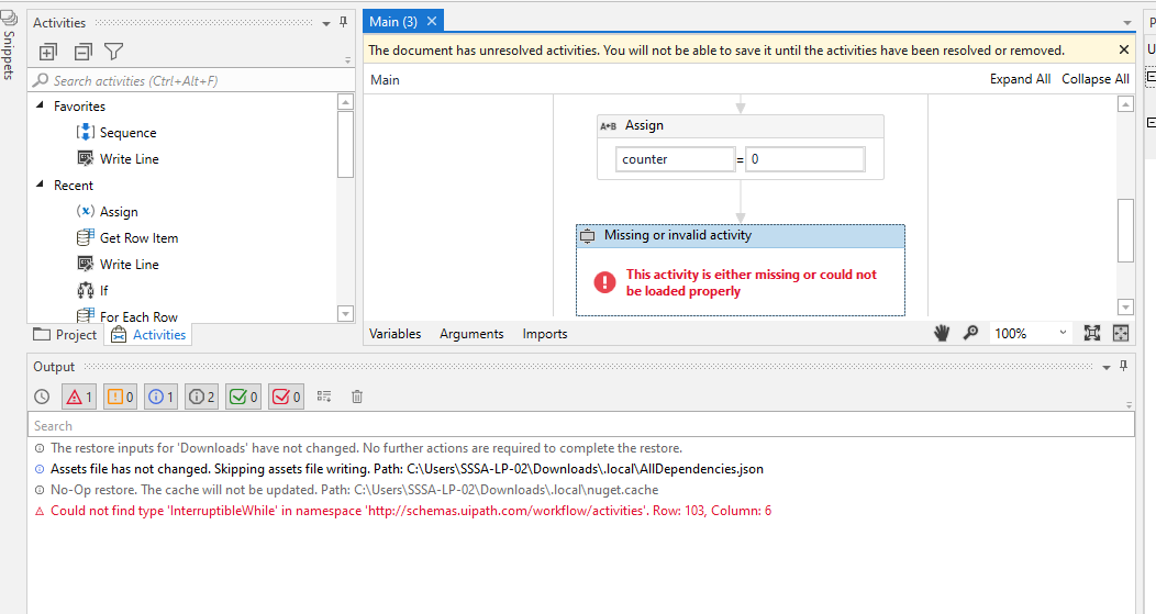

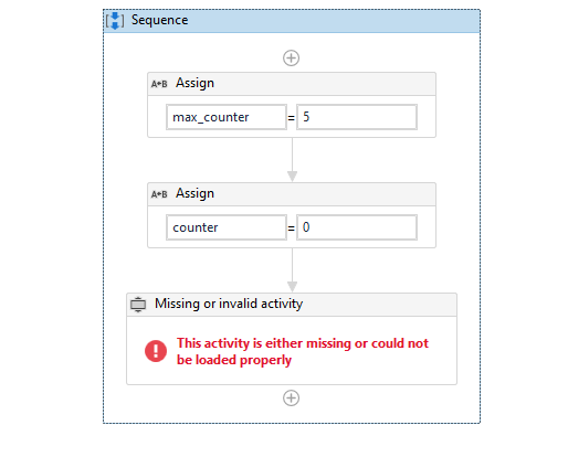

@NIVED_NAMBIAR this is the thing i’m getting after opening it
same error I am getting
@Addy_619 which error you are getting
when I am opening his workflow have you got solution can you share it I am also facing same problem as yours.
@Addy_619 install any missing packages or update
have you tried what he suggested & can you share workflow. if you have tried.
got it thanks!!!
