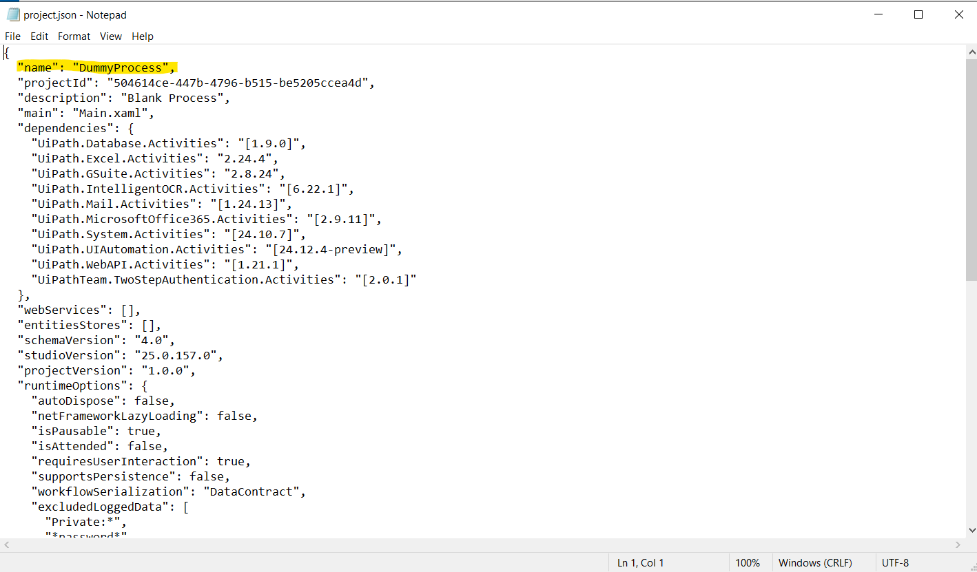

You have to change it in project.json
As you can see below, Open project.json in notepad or VS Code and change the name.
It should get reflected on your studio
Note: You cannot change it by opening the project.json on Studio as it will open as a Read-Only

Hi @Sanjay_Bhat
Go to Project.json file and change the name which is in first line. Save the file and open the process again you can see the change in Project name.

@Sanjay_Bhat ,
once you have done the changes in project.json file. Points to keep in mind
  1. Make sure to save it before closing
  2. If any instance is already opened for this process then close it and reopen it from the beginning
    if you will follow these steps, your issue will get resolved
