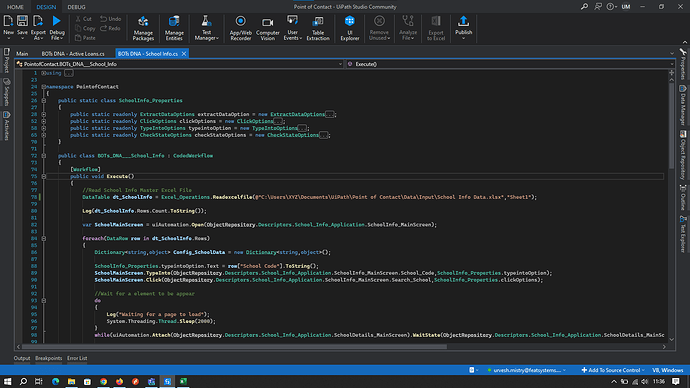

Kindly find the attached image below where we perform the automation by doing coding as shown in image.
Where as “coded workflow” is type of workflow in UiPath. You can see the same in the attached image.
Now, The answer I am seeking is how can we use UiPath In-Build Activities in this “coded workflow” in-order to perform excel automation.
I hope now my query is clear to you.

Thank you for your response but I am aware of working fundamentals of the excel activities. It would be helpful if you can help with the coding. So far there are no official written documents in the same regards.
Hi @ABHIMANYU_THITE1,
I am aware of the solution which you are suggesting but here, I am trying to explore the coded workflow to it’s full extent and really wanted to learn, how to perform excel automation using coded workflow.

Hi @naveen.s,
I have performed the similar code, but it is showing error like this.
As you can see in the image, “WorkbookPath” takes “InArgument” (InArgument of String).
