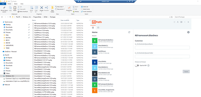

Hi All, I published REframework.BizeDocs.1.0.10 at a different machine which has a development license and moved the package over to this machine. I can’t see the option to update the process in assistant. Do I need to do anything else?
Regards
Anived
Hi @Anived_Mishra
If you run the process it should install the new package automatically and then run the new version
Regards
I tried running from studio and it runs fine however I cannot see it in assistant to install afterwards.
The solution was, an identical folder need to be present on both machines where the package is published.
