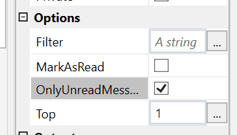

hi,
in the properties check only unread option and top =1
Hi ,
@vr24 - This is give us unread message, i am aware of this property. My request is totally different. I dont want to read all unread messages.
