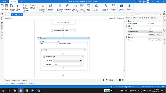

if possible, can you share me the code and for your earlier suggestion, i have tried with for each, what datatype of argument should i provide if i am using queue_item.specificcontent in for each? when i give the Object, I am getting key and value of a queueitem field together
U should give Dictionary (String, Object) in the type argument

queueItem.SpecificContent
also a dictionary datatype you can directly use it and if want you can assign it to another dictionary variable.
Dictionary type should be
Dictionary<string, object>
This does not help me, I did this with for each, but I want to use a simple query to get all the keys & values of a queue items into dictionary. where as the above solution is only for single field(key) in a queue item …Is there any query to get all keys and values of a queue item into dictionary with single query?
