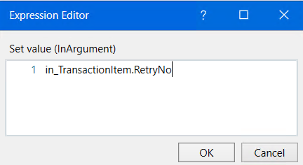

@Raj_96,
You can get that from TransactionItem.RetryNo
Remember the RetryNo starts at 0 means fresh transaction running first time will have RetryNo = 0 and so on increase as per the times retried.
