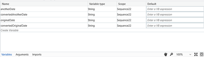

Hi @beginner_RPA
Try this:
Assign activity -> anotherDate = "04/29/2024"
Assign activity -> convertedAnotherDate = DateTime.ParseExact(anotherDate, "MM/dd/yyyy", System.Globalization.CultureInfo.InvariantCulture).ToString("dd/MM/yyyy")
Assign activity -> originalDate = "18-Apr-2024"
Assign activity -> convertedOriginalDate = DateTime.ParseExact(originalDate, "dd-MMM-yyyy", System.Globalization.CultureInfo.InvariantCulture).ToString("dd/MM/yyyy")

Variable Types:
