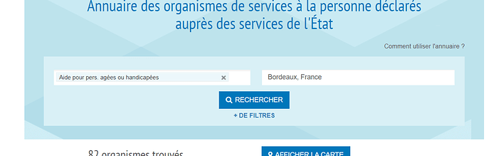

hello everyone,
I wanted to extract the data from the web site https://www.servicesalapersonne.gouv.fr/ , by clicking on the button each “voir la fiche détaillée” and do the extraxtion. the problem is they have the same selector, do you have any idea how i can solve this problem?

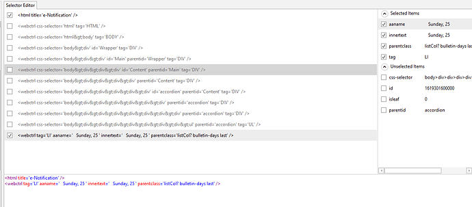

I have to browse the main line, after clicking on the button, because there I see idx = ‘4’ which increments, but I have a div = “divResult0” on the list I have several divResult, I tried div = “divResult *” this will not work
what sometimes works for me in these situations is to analyze the tree structure in UiExplorer and find the parent element where all entries are listed and then use a Find Children activity on that parent element. If you can, try to filter the elements by XML filter!
Then loop with For Each UiElement and you can take this UiElement variable (item from For Each iteration) and use it for UiAutomation instead of the selector.
