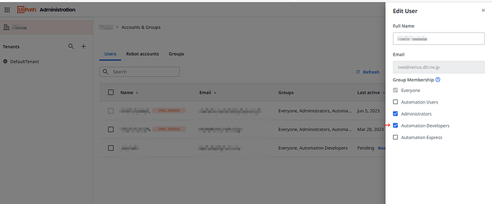

Next can you check if your account is assigned to AutomationDeveloper in Admin - Accounts&Groups?

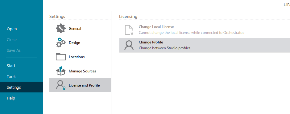

Do you need to change StudioX to Studio, right?
If so, is there “Change Profile” as the following? We can change it via this menu.
At this time, local license can be available in Enterprise license.
That option was not there when I last checked. But it’s there now!
