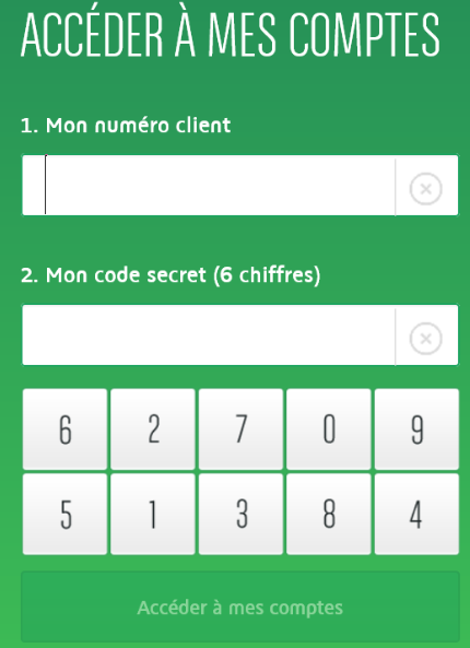

How to be able to click one digit represented as image in WebPage?
Dears,
How to be able to click one digit represented as image in Web-Page?
Please find an example below where the positions of digits from 0 to 9 is changing each time.
https://mabanque.bnpparibas/fr/connexion
Note : Digits here are not recognized as button as shown in google online calculator :

Inspection with UIExplorer gives following selector for number button:
html htmlwindowname=‘15643351526200.2460097307028955’ title=‘AccĂ©der Ă  mes comptes en ligne | BNP Paribas’
webctrl idx=‘6’ parentid=‘secret-nbr-keyboard’ tag=‘A’
You can use idx info for the differen numbers
idx 1 = Number 2
idx 2 = Number 9
next row: idx 6 = Number 0
So with the help of a dictionary you can define a lookup table
e.g Key is number, Value is index
With this the selector can be constructed within an assign activity and be used for the click activity

I didn’t get your question in detail so I just summarize my analysis work for you:
  • I opened the Link that you have provided in your first post
  • I opened UiExplorer in Standalone mode: UiPath Studio > Design > UiExplorer
  • With the standard functionality “Indicate Element” pointing to one digit button and analyzed the selector result
  • From there I copied to the post
However lets focus on the solution and get your workflow working. I suggest you to work with selectors and Click activity as it has potential to be more reliable and independend to image recognition.
Let me know your open questions
