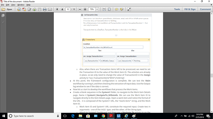

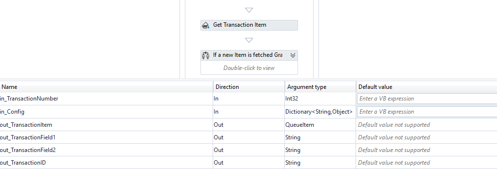

I need to assign it in a assign activity as demonstrated in the Academy 2.0 doc. PLease find the screenshots for reference.

Hi @pravesh_kant,
The Assign Activity that you have mentioned requires a System.Data.DataRow out_Transaction on the left side and in_WIList(in_TransactionNumber) on the right.
There is no use of QueueItem in here since we are not using Orchestrator Queues in this academy assignment! Please refer below point from the academy doc.
