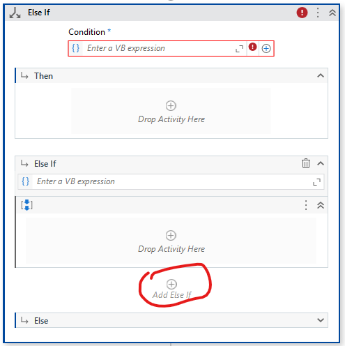

@Terry_Marr,
Ohh wait…There is easy way added in recent release. You can add Else If without worrying about Else part. Tried this on UiPath.System.Activities version 24.10.3. Update and try.
Else If
Thanks,
Ashok :slight_smile:
We usually use 23.4 of UiPath.System.Activities. I just tried it with 24.10 and they have indeed fixed this.
