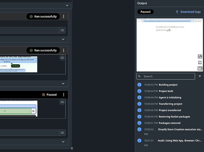

Hello!
I am running and automation and locally do not run into any cloudflare captcha, but when using the remote viewer, the automation runs into a cloudflare “i am human” checkbox
How am I able to select an object in the remote viewer to target if I cannot replicate it locally?
Ideally I would just want to add clicking the cloudflare checkout as a step in the automation, but I am unsure how to target it.

You cannot get from remote view
No it must detect my browser/connection and it almost instantly auto fills this field.
How could I locally mimic the remote testing environment to try and replicate this in order to select it?

I dont think so…you need to somehow replicate it …even if you open using ui robot on local machine are you getting this?
Try to run the bot on local machine via orchestrator and check
Thank you for your insight! I was able to replicate this!
