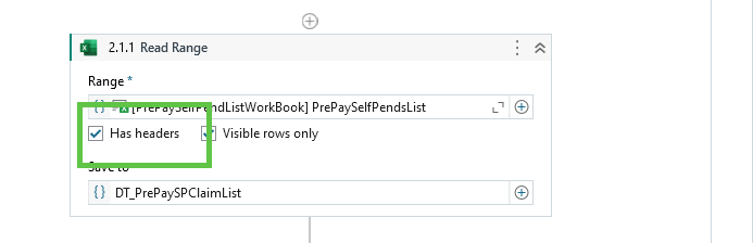

The source is an Excel Spreadsheet, using the ‘Read Range’ activity. Here is that activity. I have the option ‘Has Headers’, which is checked. I do not see an option anywhere to check ‘add headers’. The ‘Read Range’ activity is inside a ‘For Each Row in Data Table’ activity.
The filter being applied is for column 1, filtered to a specific employee number.

Yes I meant has headers only :slight_smile:
You said you are using read range activity inside a loop?
Can you show screenshot of your workflow please?
You don’t need to put this activity inside a loop. You simply read range and it’s gonna read the data from excel and save as datatable.

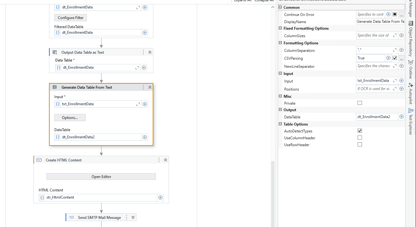

You can debug it using Create HTML Content activity before passing it to Send Mail.
It is actually a known issue, the workaround will be to
Output as CVS
Generate data table again
Use Create HTML Content to build body (HTML Content) - (debugging)
or just use the second data table in Edit HTML Content of the Send Email
It looks like this
