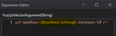

Hi @Aki1111 ,
It depends on what you mean as more dynamic if the selector is changing you may want to pass dynamic values through a variable, for example, here I pass a variable to find the correct row on a table.
Other strategies could be using the UiExplorer to find more stable attributes to build your selectors, also consider using anchors and CV as a fallback method.

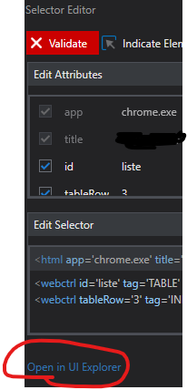

The fact that it says “get text ‘pending’” makes me think you have the value of a field as part of the selector, so when the value is different then the selector fails. What exactly are you trying to do?
Hi @Aki1111
From what I understand, you are trying to fetch the text from aaname or inner text property of the element.
So in such cases, you should tune your selector around other properties such as tablerow, tablecol if it’s from table cell or let’s say class or id of that selector.
You don’t use aaname or inter text property in a selector for which you are trying to get text as I understand you are trying to get dynamic text shown at the moment. Specifying these in the selector would restrict the selector tor to only fetch value when text is pending.
If you open/explore your selector in ui explorer, you will be able to see what other properties can be used instead.
You can share screenshot here with us from Uiexplorer for your element and we can also help you fine tune the same.
