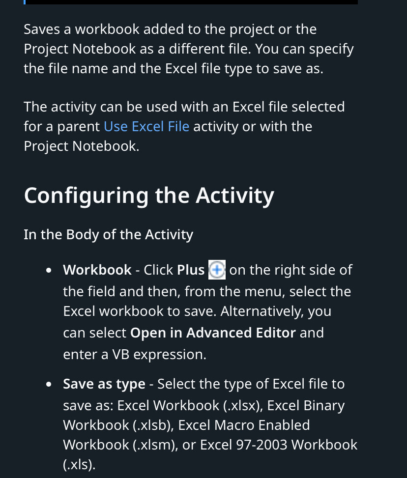

I am using 'Save Excel File As" within a ‘Use Excel file’ activity. I need assistance in performing the following.
An app separate from Excel generates an Excel spreadsheet and launches the result as “Book1.xlsx.”
I need to save that file to a specific location and with a specific name.
I have tried referencing the generated sheet as ‘book1’ using a string variable. It saves a blank file.
The location works in the second box; I just have been unable to save the actual sheet instead of a blank one.
How do I properly reference the ‘Book1’ sheet so that it can be saved?

Save excel file as is used to save already existing excel file with sifferent extensions
You need to understand one thing here is that a handle is needed for these activities to work and the handle is provided by use excel file and for use excel file to create a hnfle you need to specify an input file as book1 is not saved at all there is no way to give the path
One way you can try is to use macros and then attach to book1 and try saving it..but only with activities you cannot
