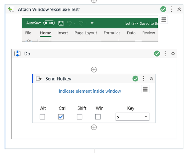

You can try the below way:
Use Attach Window indicate the excel file and you can use send Hotkey Ctrl+s to save the excel.

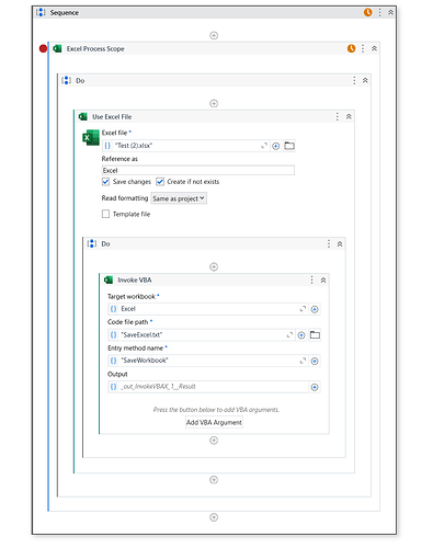

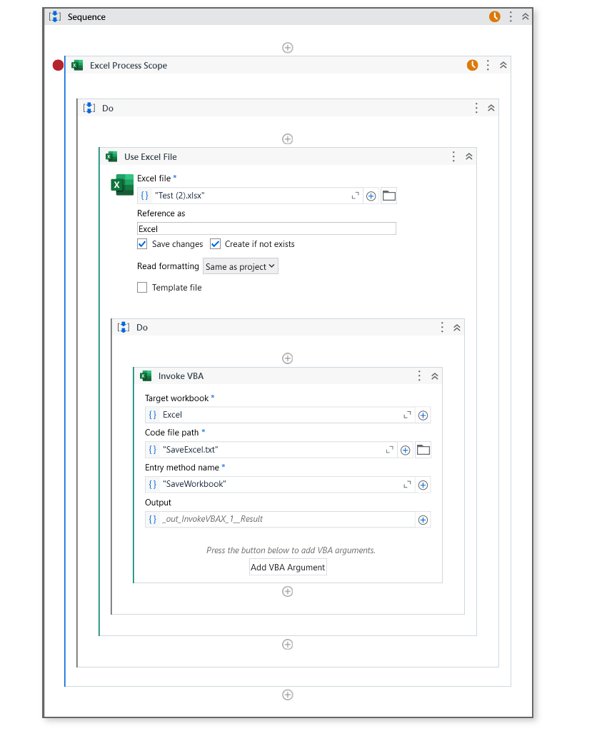

If you are using Modern activities you can use the below VBA Macros code to save the excel
Sub SaveWorkbook()
ActiveWorkbook.Save
End Sub
Save the above code in text file and follow the below workflow:
SaveExcel.txt (54 Bytes)

Thanks for your suggestion, unfortunately, my UiPath is a locked to lower version where I don’t have Attach Window activity. I just found a different solution where I use click event to save and give input in the file name section along with the full file path.
Yes it is been solved.
here is the solution i used.
