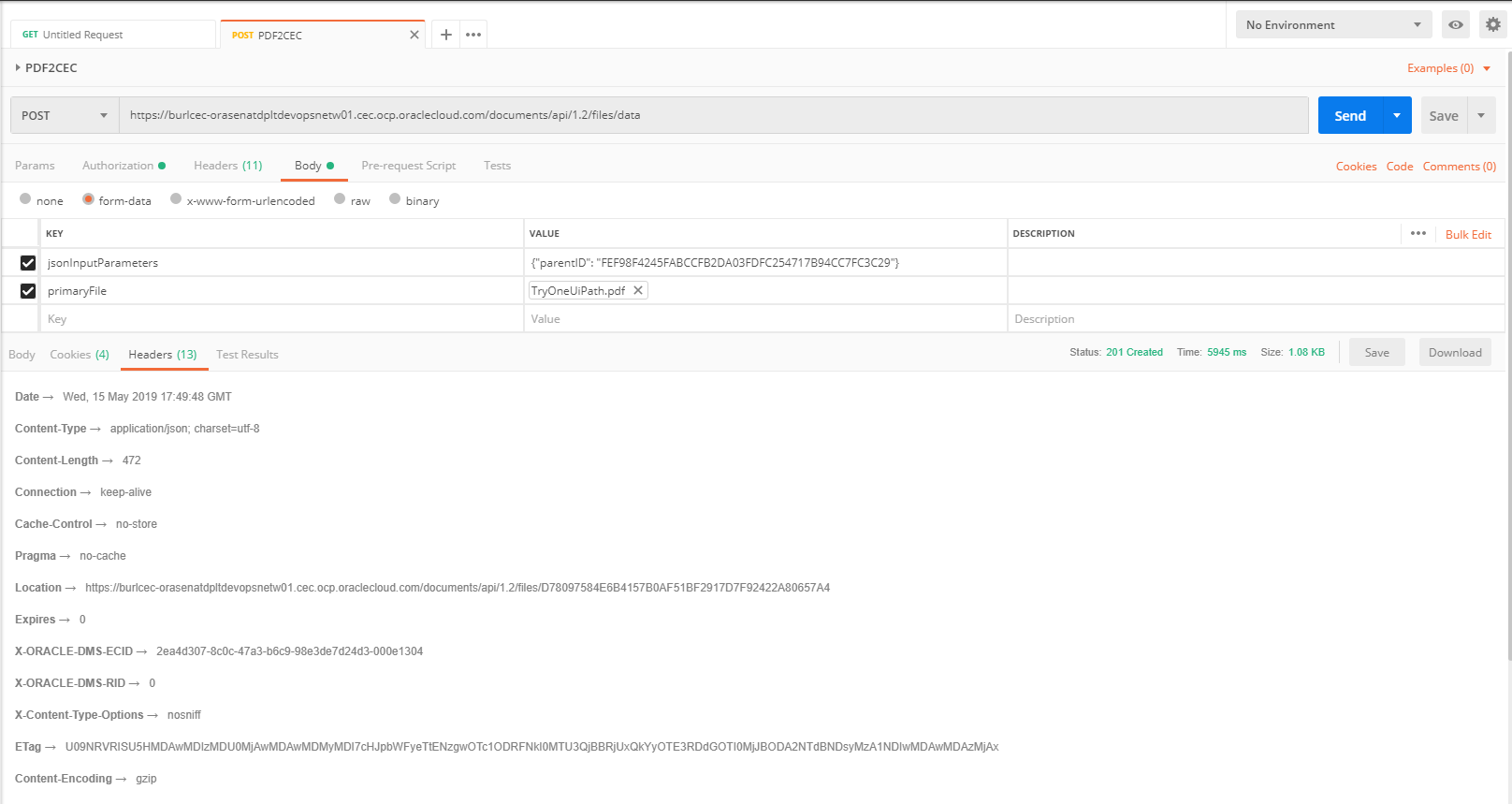

Hello,
I have checked here: How to send a Body type "Form Data" using POST in a HTTP Request
and here: How to pass JSON in HTTP POST request body? - #2 by loginerror
I’m trying to upload a file. I can do it in postman:
It fails in uipath:
Any help appreciated.

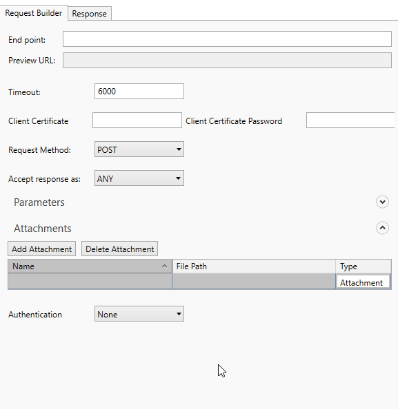

I just saw the file you have attached as a form data,
but we have the option as in the screenshot
Can you try this one?

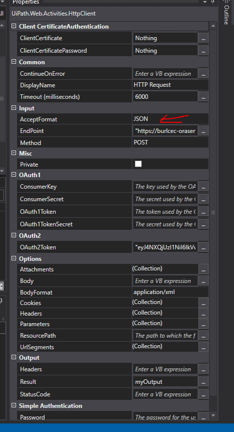

@kyqurikan ,
Can you please change the Accept Format as JSON and try.
Thanks,
Arunachalam
