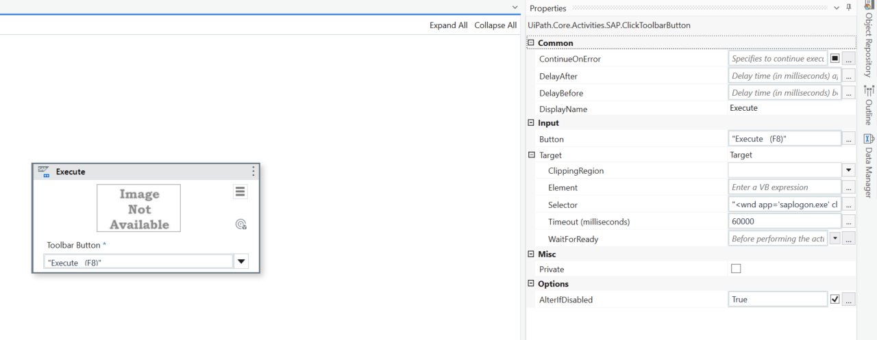

Hi! I am trying to automate SAP GUI report extraction process but some of the reports are huge and takes >15 mins to load (15mins before anything shows up on the SAP GUI status bar. meanwhile i could only see the bar keeps running on the top of the screen). i would like to terminate the job and move on to the next extraction request if any report takes >1 minute (for testing purpose) to finish running.
I used a SAP Select Menu Item activity > Execute and set the timeout property of this to 60000ms but it did not terminate the job after a min. – SS1

SS1

Hi Gautham,
The bot won’t move to the read status bar step after i click execute if the SAP is still loading.

Hi @ellie.liu ,
Delay activity is what i suggested instead of time out.
To illustrate lets say you are using a click activity with time out configured the functionality of time out is to wait for the mentioned time before throwing exception if click is not successful.
Whereas delay will help you wait post the click if you add seperately.
Also if the bot seems to be freezing thats coz the application you are interacting with is actively executing.
Try using a parallel container, in left half keep the menu item selection and in the right half add a delay and the rest steps suggested in the first post this would help you out.
Since you would be making use of parallel activity consider adding some 20 or more seconds so that click is executed and 1 min wait time is there.

Hi Gautham,
I’ve set the do while to stop after 2 min but it does not exit the loop even after 2min

Hi Gautham,
thanks for your help.
I’m using a for each row and i dont want the bot to wait through the delay for every row.
instead, i would like the bot to look for the element > log message > if exists then move to the next step else loop back to look for the element. this looping to look for the element should not exceed 10mins (for example) > if element do not exist after 10mins, send error message.
Hi @ellie.liu ,
Try modifying this way with the looping method
Before loop initiate a TryCounter of type int32 with count as 1
Do while Loop
Body :
Element exists to check if it is loaded
If condition
Loaded - Next steps
Else
Delay activity ( configure for 2 minutes)
Outside the if condition
Increment the Try Counter by 1.
Condition of while
TryCounter < 6
This will be executed 5 times wait time will be 10 minutes.
Add the same element exists activity after the loop
Check with if condition,
Else part
Throw the exception or log the message not loaded after 10 minutes.
Hope this works for you.
