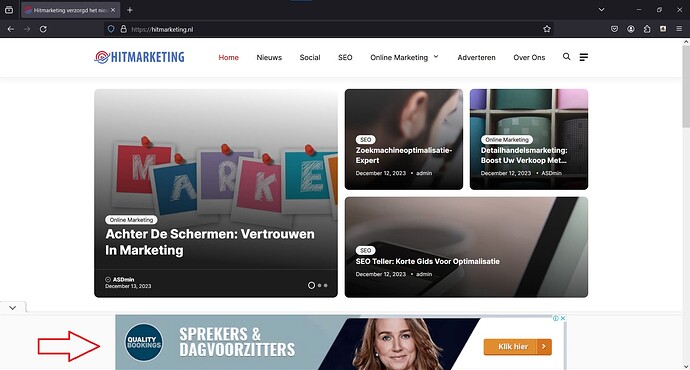

Let’s say for example here I want to click on this ad(just an example, disable adblocker to see it, or incognito)
If I use this strict selector it is working
<webctrl id='aswift*' tag='IFRAME' parentclass='adsbygoogle adsbygoogle-noablate' src='https://googleads*' css-selector='body&gt;ins&gt;div&gt;iframe' idx='2' />
<webctrl tag='*' />
But suppose the ad format changes to texts from banners, the selector is changing as well, but it shouldn’t change cause the position of the ad is same and it’s fixed.
Like here the ad format changes to text like this, it doesn’t work anymore:
The selector changed to this:
<webctrl id='aswift_5' tag='IFRAME' />

This is the website I am testing on the example:
https://hitmarketing.nl/

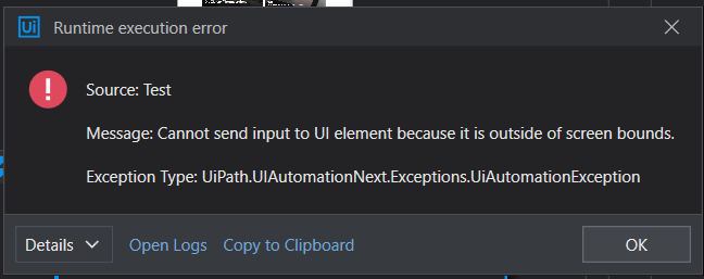

Wow. now it seems to work. Only problem is that it is only taking Hardware events or windows message clicks, not taking simulate clicks, where as simulate is working on other parts of the site. I seem to miss something. Can you please check?
@Anil_G Sometimes getting this weird error on the click activity, any idea what it could be due to:
@Tejaa
Try using sumilate…looks like the element you are trying to click is not visible on screen
cheers
I see. Simulate click seems to disappear the error but the click is not happening in real. I even tried Simulate with delay before and windows-message with delay before.
