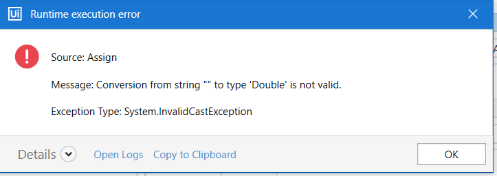

Hi @supermanPunch : As you solved my previous post but I am experiencing the error again. I shall be very grateful if you look into the attached .xaml file and screenshot. I am really fed up, pl. humbly request to help me out.
Many thanks,
PP_FlowChart_Testing.xaml (25.0 KB)

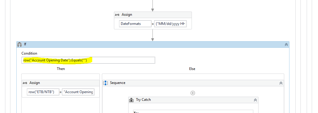

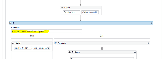

Hi @Dr_Raza_Abidi_PhD ,
Could you try Changing the Highlighted Condition in If Statement in the below image to the below Condition :
String.IsNullOrWhiteSpace(row("Account Opening Date").ToString)
The Error occurs when there is an Empty String in the Account Opening date Column, but since it is already handled in the Outer If, there should be no conversion problem of the Date.
Let us know if you are still facing issues after you have changed the condition.

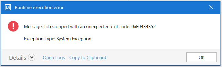

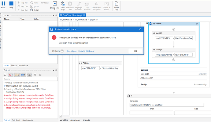

@supermanPunch: Thanks, following is the screenshot for your reference and it took almost 10 minutes to execute but failed and stopped with an exit code as mentioned in the screenshot.
Hi!
Perhaps the problem is caused by a large amount of data. Try to significantly reduce the table and start the robot.
If the issue does not occur, then the problem is not in the robot, but in the amount of data.
@Sergey_Petrenko : Yes, indeed, the problem is with large amount of data but it is my requirement to produce the outcome at 225th column with 205K rows. But as per @supermanPunch, I should take those columns which are required and afterwards, join the data table activities.

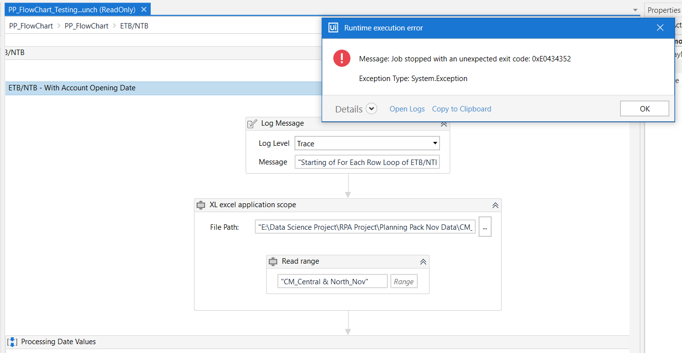

@supermanPunch : Pl. find below the screenshot of the current scenario I ran as per your instruction. It took 10 minutes to come up with an error writing the data into the same reading file of 224 columns:
I ran this file of 224 columns with 10,000 Rows, It perfectly works fine but when I ran on 205K rows terminates with an error exit code as mentioned in the screenshot.

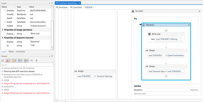

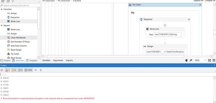

Hi @supermanPunch : Pl. see the screenshot. It seems unusual behavior, sometimes showing the integer value and sometimes show the proper date.
The Integer part is also handled in the Try Catch Block. In the Catch Block we are converting the Integer or OADate value to it’s DateTime format.
But Could you make the process run and then show the Screenshot of the Output Panel after the Error is Thrown
Need to Check if there is any other value present which does not correspond to the date column.
As an alternate, I will work on using an If condition instead of a Try Catch.

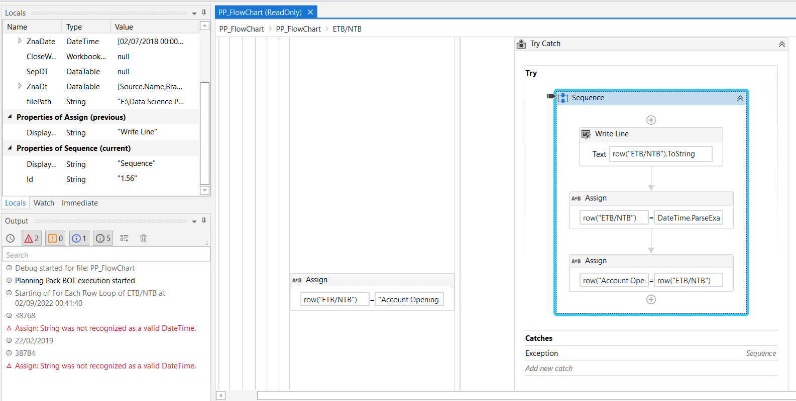

@supermanPunch : I have run the file from Debug File and checked the Write Line showing data with no abnormalities seen but at the last gave the error with exit code. Pl. see the screenshot.
Thanks,
I have made a Bit of modification to the workflow that I think is the one you’re referring to.
Since we only need the XL Scope for Reading the Data in Excel and Not Processing Datatable, I have kept the Processing of Values in Datatable outside of the Scope.
Also the Try catch block is Replaced with an If Condition Statement, just to avoid Error being thrown every now and then.
Let’s Check if this gives any performace benefit.
Check the Updated Workflow Below :
PP_FlowChart_Testing.xaml (30.0 KB)
