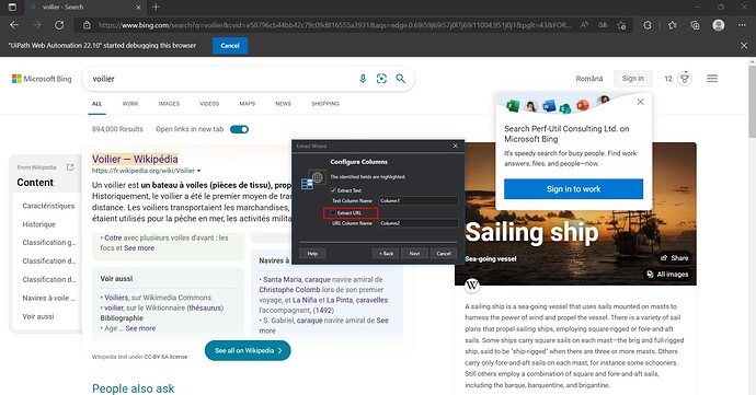

I would like to extract the url link and the title below.

Can you show us exactly how you have indicated?

Have you selected like this? @Octave_Descours
Uninstall your extension and reinstall it again and check again
After selecting first column you will shown a popup where you can use extract url so that it will get you the url too of that particular line
