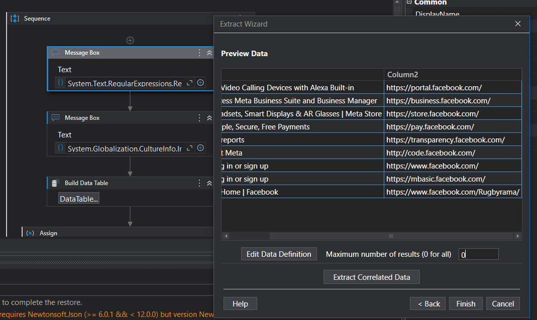

can i see a bit what are you trying to extract?
@fernando_zuluaga

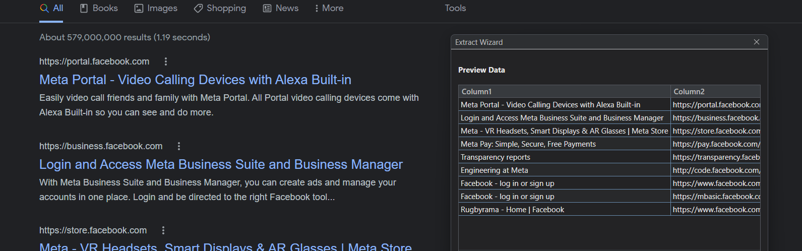

I can get the results @harshil
I hope this is what you are trying to extract

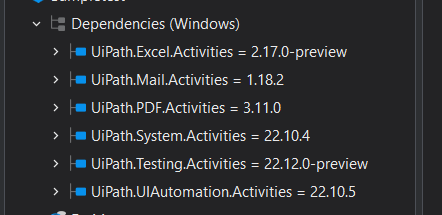

Here are the dependencies
