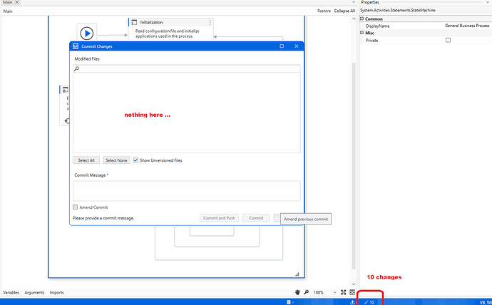

Looks like am stuck with a branch and unable to push changes to git as the changes are not being recognized by Studio. Any ideas how to fix this ? See screenshot.

Hello Shekar,
It could be due to incorrect git configuration; can you check the Git repository URL in studio
and check that you’re working on the correct branch. If not, it can be Authentication issues as well.
Hi @Sekhar,
By any chance, have you changed your credentials lately and skipped to change those in here?
When you go to studio-> team-> are you able to see “Disconnect” and “Change signature” options as enabled? if yes, it means you are connected, if not, something is messed up in your connection.
You can try below workaround:
Sometimes, cloned repository can get messed up thus disallowing committing changes to the repo, but trying above steps should do the needful.
Regards
Sonali
Also faced the same (Studio 2024.10.1).
My problem was I had a git tracked file which had been renamed, but it had only changed the case of some characters.
e.g. workflow was InstrCSVMULTI_TransformData.xaml and I had renamed to InstrCsvMulti_TransformData.xaml.
What worked for me:
I renamed the workflow - to InstrCsvMulti_TransformDataV2.xaml and the tracked changes worked fine again.
