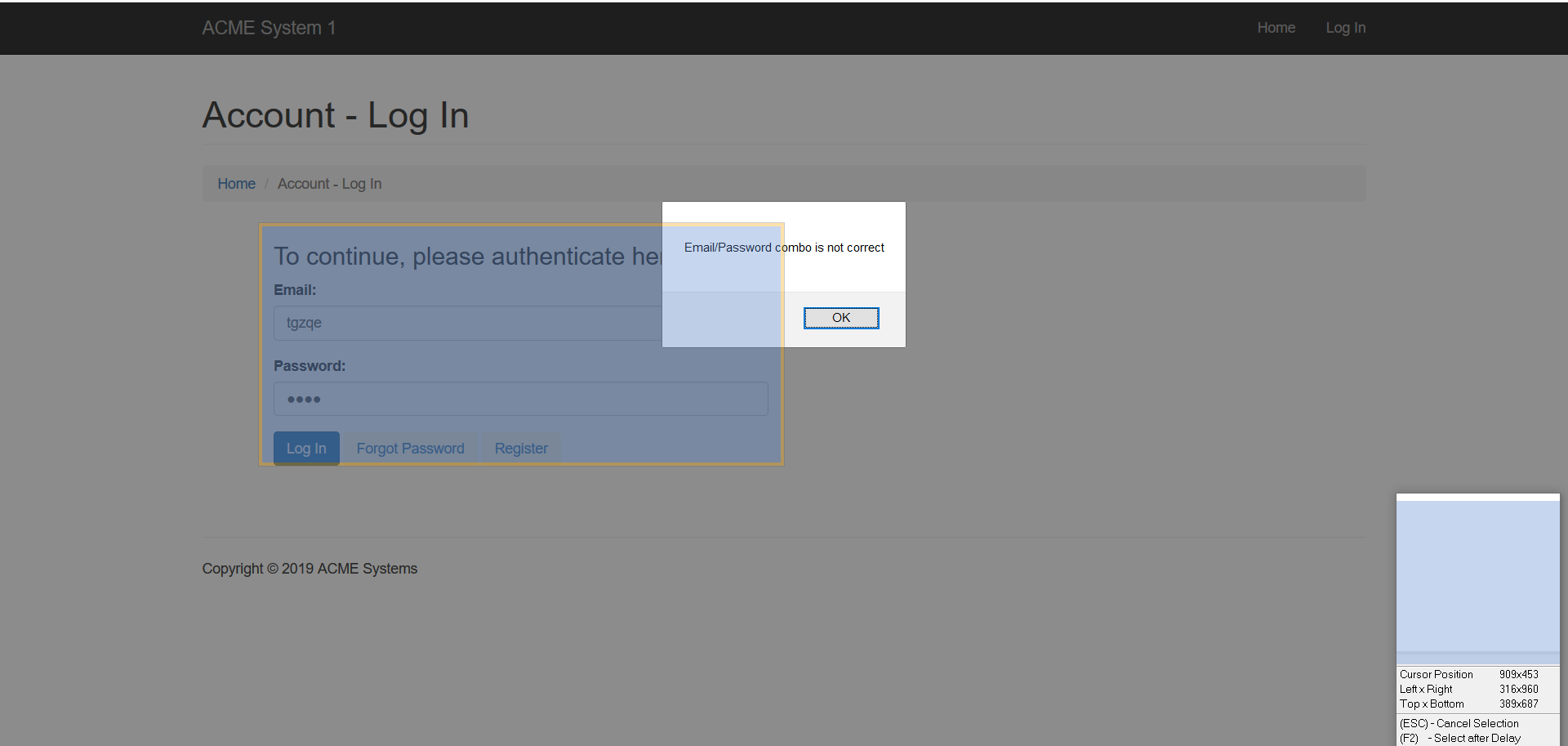

I have a problem with Firefox : the error popup isn’t reachable with any selector, through UiExplorer or even with clics and sent hotckeys…
Here you can see the popup :
And here you can see what UiExplorer find in the window :
By clics and hotckeys, I mean I tried to clic in the popup, then press tab, then press enter, and it’s working fine when I do it for real, but to simulate this process, when I try to make UiPath clic on the popup image and then send hotckeys, it don’t find the image…

I don’t think my selector is false since I made it from UiExplorer :
Or maybe I missed something ?
@mcamboulives
Selector looks fine only. May i know what error are you getting here ?
Hope you are using this click Activity inside Attach Browser activity.
Well, it was the Attach Browser activity, where I changed the selector but not the browser type… :flushed:
