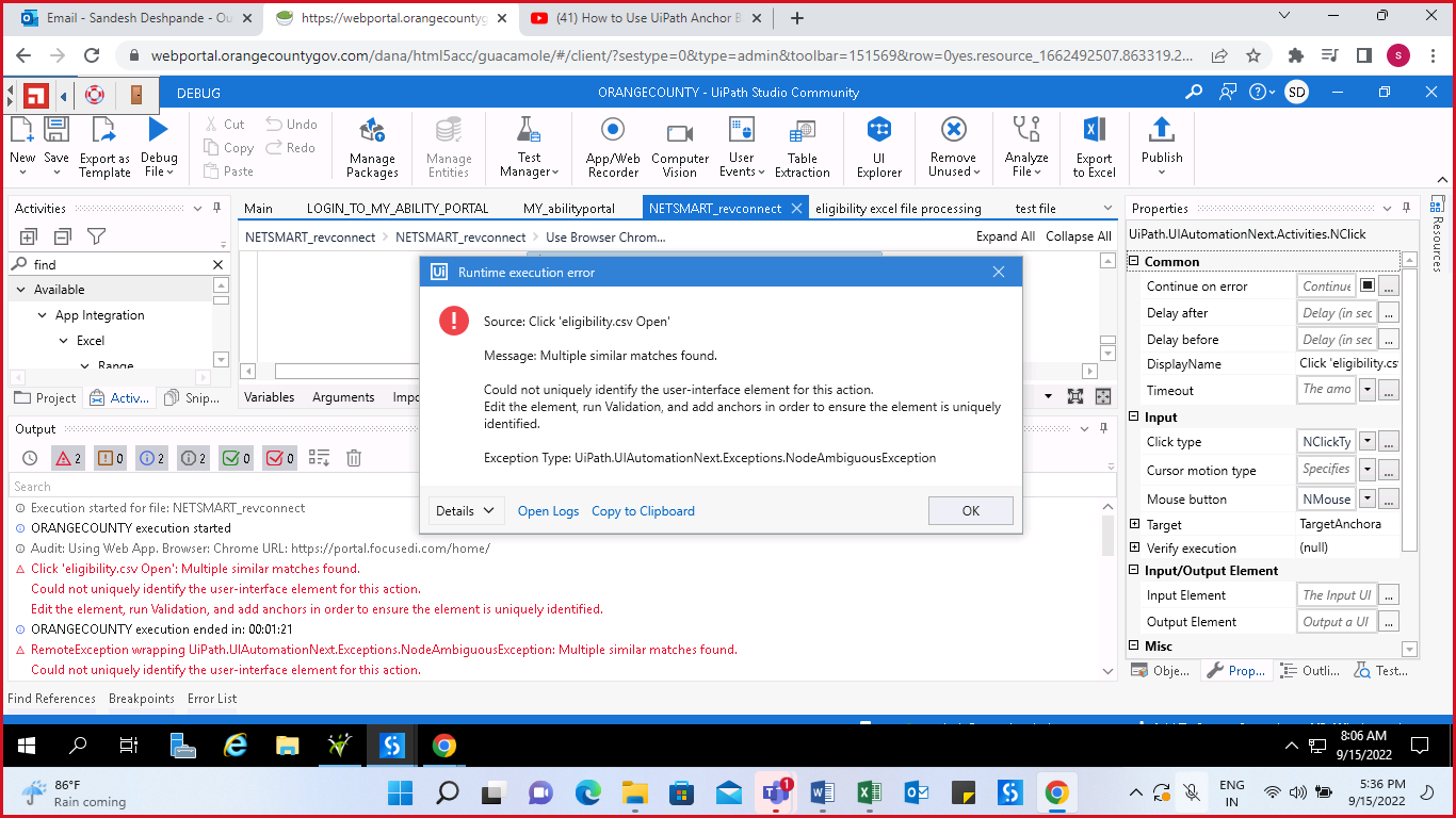

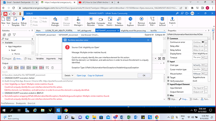

Getting an error while clicking on the next button
Hi all
while clicking on next getting error
have used click activity its not working

Hello @sandeshdeshpande726,
The selector you are using to click the Next button is too vague, the automation is finding multiple elements that match the criteria.
Open the Ui Explorer on the errored activity and play with the selectors to mke sure that the next button is the only thing that can work e.g. InnerText or AAName as “Next” or something.
From the error itself it’s clear, that you have multiple similar elements in the application? It would be better if you can share the screenshot of the application. Also, if you are using the modern click activity, it will get the auto tag to an anchor. That will help to solve your issue.
