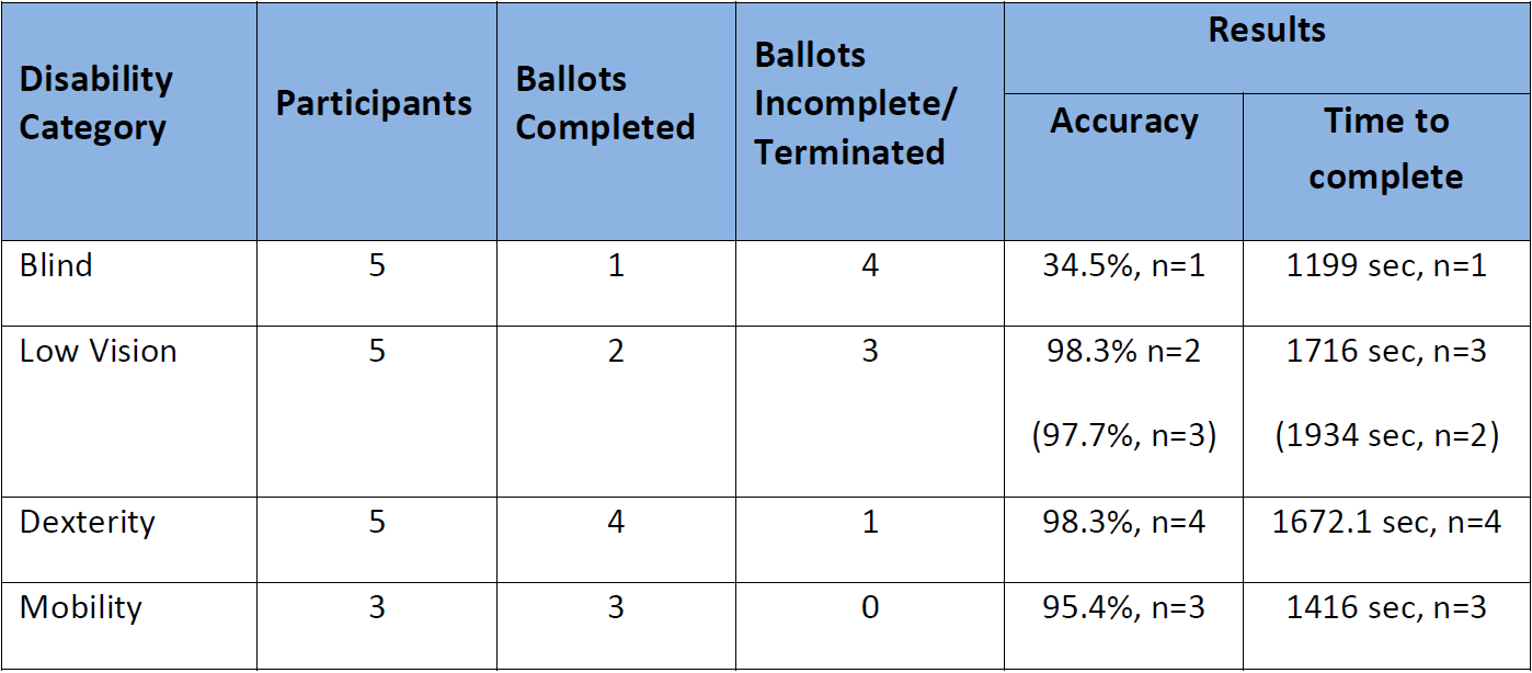

I have one pdf in that i need to extract a table
I tried with screen scraping not working,can you suggest

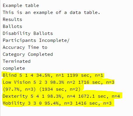

@varunk One solution is, as its a readable pdf use Read PDF activity to read the entire content of the document. The result of this will be,
Capture
  • Retrieve only varying data(highlighted content) from the result and use “Generate Data Table” activity to build a datatable
    or
  • Use regex to retrieve the highlighted content and build a datatable looping and formatting the result retrieved.

Yes that I know,but here I want to extract entire table in pdf how it looks like

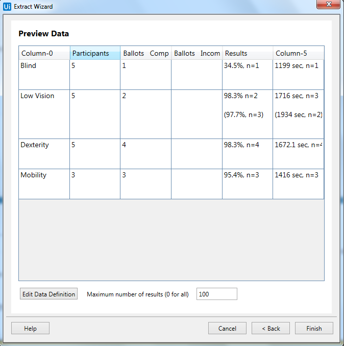

Have you tried Data Scraping instead of screen scraping. I have checked data scraping and it’s working on my machine.

Hi @Bharat,
Your flow not getting output,showing empty data.
When I use the data scraping it will show the below error
