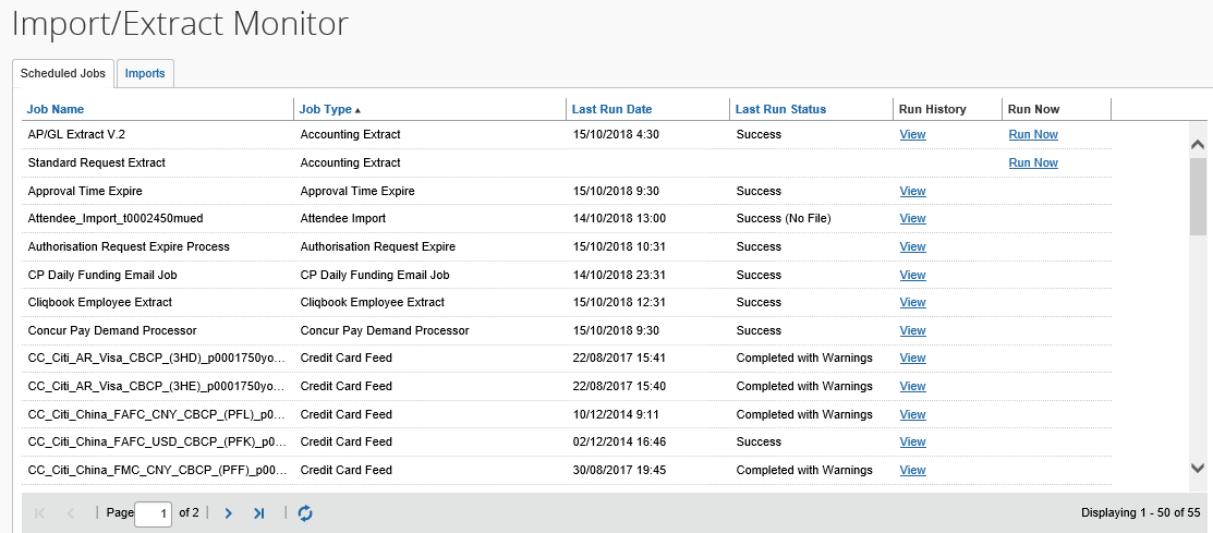

I have a table that looks like the below
When i try to extract lis as table ,it considers eacl line as table and extracts only one line .
Any help on this please …
