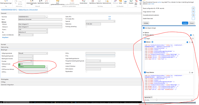

Now, when I do this, for the first iteration it’s going good, I retrivede 3108782489 as a CVR number since CPR number is empty.

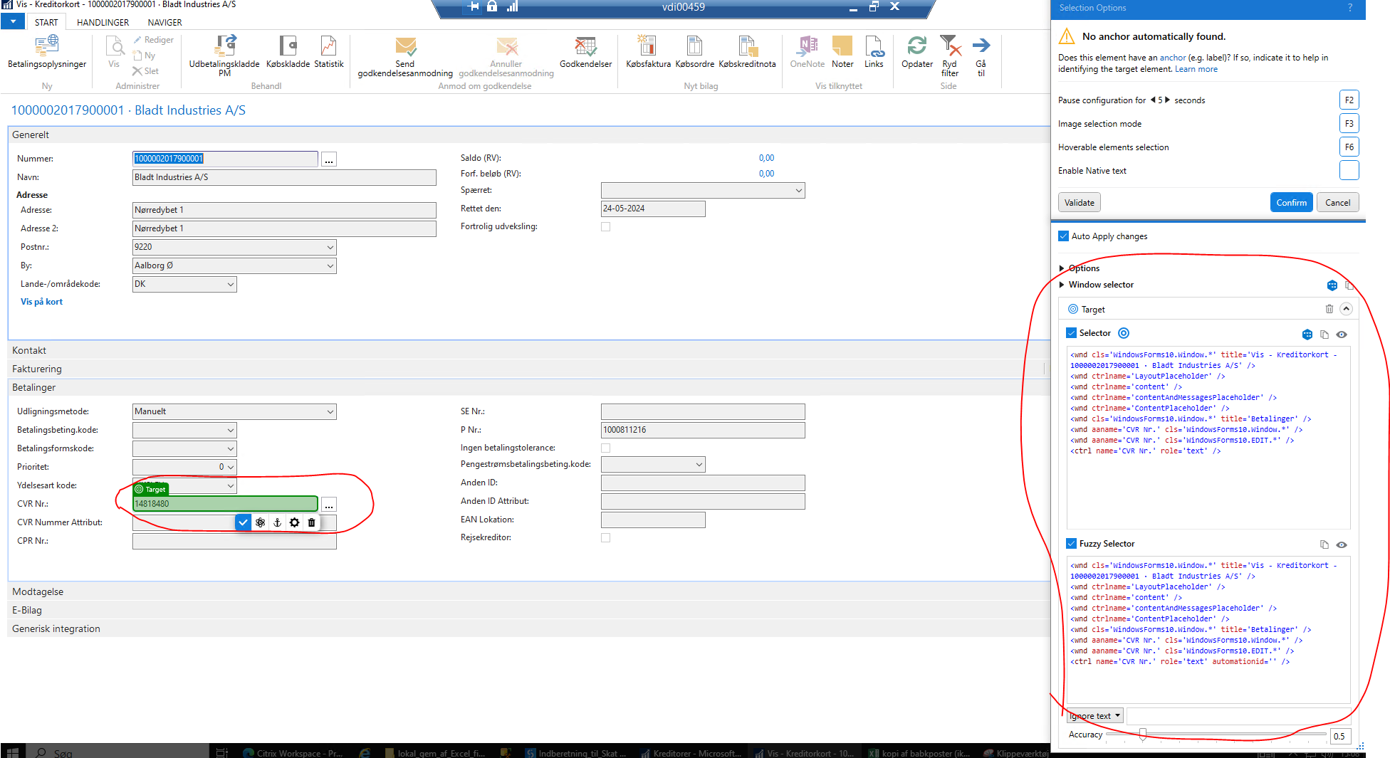

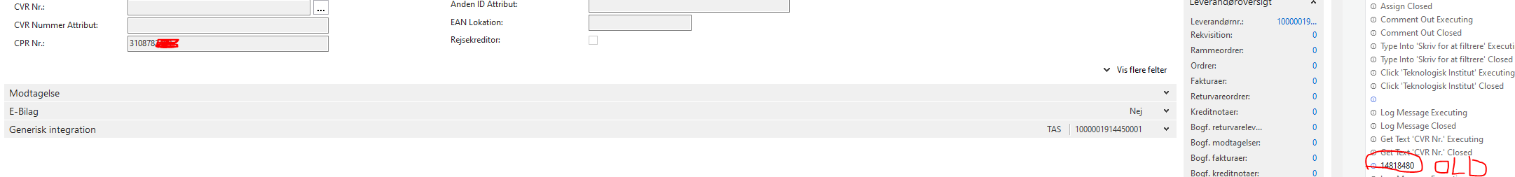

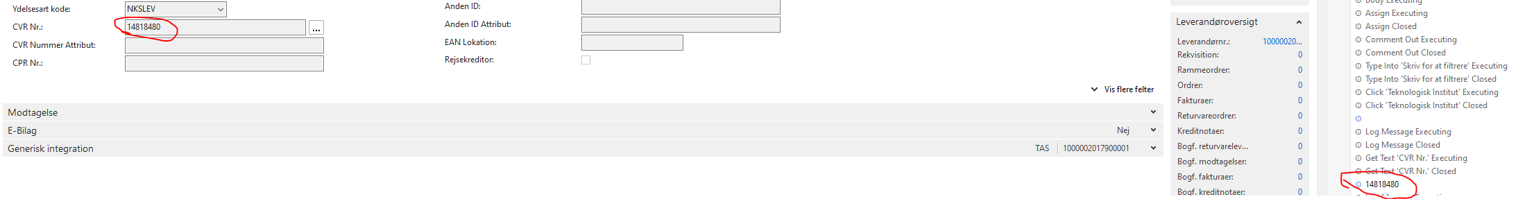

The problem is,that on the next iteration, when I want to retrive either CVR or CPR for the next company than the same data, “3108782489”, is being given which is the old CVR number for the previous company. I suspect this is because of not having dynamic selectors, but I want to hear you guys first.
Down below is the first company:
And down below is the second company but UiPath still returns the old CVR number “3108782489”:
